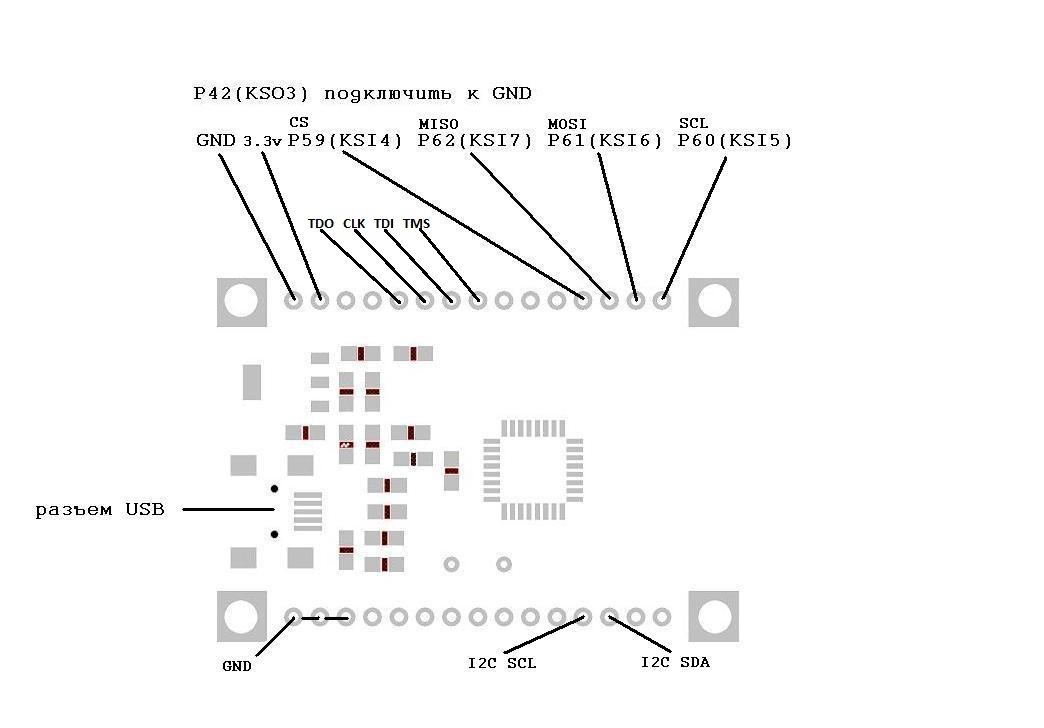

hello, where in svod1 i can connect clk tdi tdo tms rst# for mec programming ?
Re: Svod1 jtag pinout
Сообщение admin » 12 мар 2021 14:08
hello

one noobie question more please, rst# ? :?
Сообщение admin » 12 мар 2021 15:50
we not use RST, must be plug to VCC via 10k
