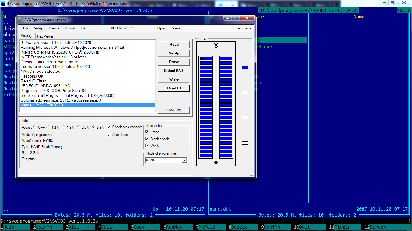

Сообщение admin » 10 ноя 2020 10:32
Software version 1.1.0.3 date 29.10.2020
Running Microsoft Windows 7 Профессиональная 64 bit
Intel(R) Core(TM) i5-2520M CPU @ 2.50GHz
.NET Framework Version: 4.8 or later
Device connected in work mode
Firmware version 1.0.6.8 date 5.10.2020
NAND mode selected
Test pins OK
Read ID Flash..
JEDEC ID: ADDA109544AD
Page size: 2048 , OOB Page Size: 64
Block size: 64 Pages , Total Pages: 131072(0x20000)
Column address size: 2 , Row address size: 3
