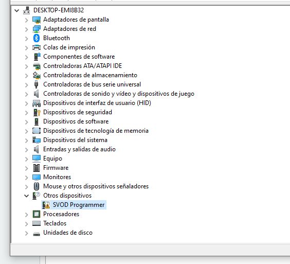

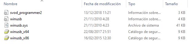

We attached the "C:\Program Files (x86)\SVOD3\driver" content in a jpeg file, and devices in our computer in a jpeg file as well. Can you tell us if you have got the same files in driver folder?

- devices_in_our_computer.JPG (49.82 КБ) 45948 просмотров
- svod_driver_folder.JPG (22.33 КБ) 45948 просмотров

Hi, Svod support contact us and we finally could install Svod programmer. The problem was a driver signature in Windows 8 and 10, that you need to disable temporarily to be able to install svod driver placed in "C:\Program Files (x86)\SVOD3\driver".
Follow the link below, to solve it, if you have any problem with your svod programmer not connecting or not being able to install it.
https://www.howtogeek.com/167723/how-to ... d-drivers/
